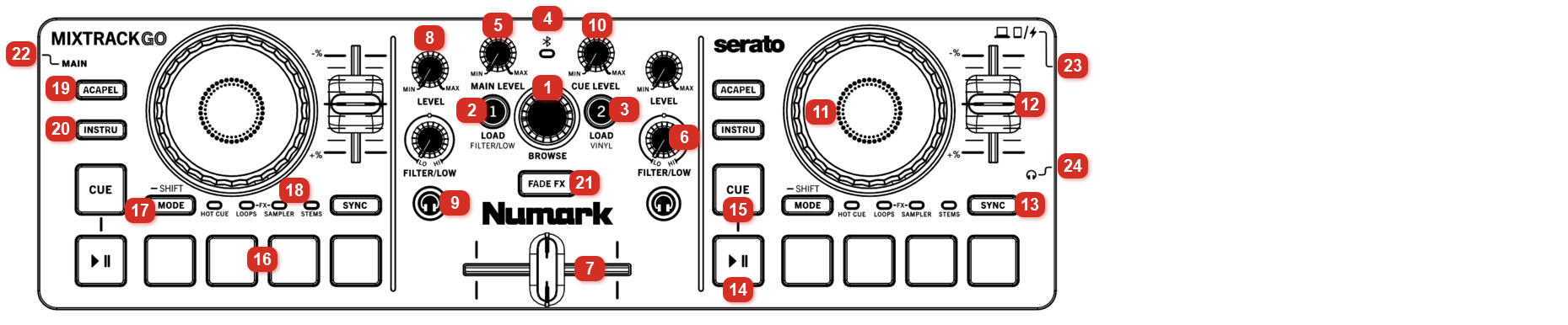

Features
1
Browse Knob
Rotate this knob to cycle through crates and tracks. Press it to move forward in the software panels.
2
Load 1
Press this button while a track is selected to assign it to Deck 1 in the software. Press this button twice to perform an "instant double", automatically loading the selected track on one deck to the opposite deck.
Filter/Low: Press and hold MODE/SHIFT and press LOAD 1 to change the function of the Filter/Low knob to control either the software Filter (default) or Low EQ.
3
Load 2
Press this button while a track is selected to assign it to Deck 2 in the software. Press this button twice to perform an "instant double", automatically loading the selected track on one deck to the opposite deck.
Vinyl Mode: Press and hold MODE/SHIFT and press LOAD 2 to turn the vinyl mode on or off. When vinyl mode is On, use the platter/jog wheel to grab and move the audio, "scratching" the track as you would with a vinyl record. When vinyl mode is Off, use the platter/jog wheel to bend the pitch of the track.
4
Bluetooth Indicator
This LED indicates Bluetooth pairing and connected status. The unit is always in pairing mode when not connected via USB and not already connected to a Bluetooth device.
  • Flashing LED = Bluetooth not connected, pairing.
  • Full brightness = Bluetooth connected.
5
Main Level
Adjusts the overall volume in the software.
6
Filter
Adjusts the amount of the filter effect. Turning the knob left and right will produce a low-pass filter and high-pass filter, respectively.
Low EQ: Press and hold MODE/SHIFT and press LOAD 1 to use this knob to adjust the Low EQ. Turning the knob left and right attenuates or boosts the bass frequencies, respectively.
7
Crossfader
Controls the blend between the two decks.
8
Channel Level
Adjusts the volume of the individual channels in the software.
9
PFL/Cue
Press this button to send this channel's pre-fader signal to the Cue Channel for monitoring. When engaged, the button will be lit. Press one PFL button at  a time to cue that channel alone and deactivate PFL monitoring for the other channels.
10
Cue Level
Adjusts the volume for headphone cueing in the software.
11
Platter/Jog Wheel
This capacitive, touch-sensitive jog wheel controls the audio when the wheel is touched and moved. To bend the pitch of the track, grab the non-touch-sensitive outer wheel.
12
Pitch Fader
This controls the speed of the music. Moving towards the “+” will speed the music up, while moving towards the “–” will slow it down.
13
Sync
Press this button to automatically match the corresponding Deck's tempo with the opposite Deck's tempo and phase.
14
Play/Pause
Starts and suspends playback.
15
Cue
When the Deck is paused, set a Temporary Cue Point by moving the Platter to place the playhead at the desired location and then pressing the Cue button.
During playback, press the Cue button to return the track to this Temporary Cue Point. If a Temporary Cue Point was not set, then it will return to the beginning of the track.
Track Beginning: Press and hold MODE/SHIFT and press this button to return the current track to its beginning.
Load Previous Track: If the play head is at the start of the track, press and hold MODE/SHIFT and press this button to load the previous track from the current list.
16
Performance Pads
These pads can be used to trigger Hot Cues, Loops, Samples, Stems, and to apply effects. To change the function of the pads, press the Mode button.
17
Mode/Shift
Press this button to change the current function of the Performance Pads. Hold this button and press a pad to perform its SHIFT function.
  • Hot Cue: Each pad assigns at Hot Cue Point, or returns the track to that Hot Cue Point. When a pad is unlit, you can assign a Hot Cue Point by pressing it at the desired point in your track.
    Delete Hot Cue: Press and hold MODE/SHIFT and press a pad to delete the hot cue.
  • Loops: Each pad triggers and auto-loop of a different length.
  • Effects: Each pad triggers a software effect for the current deck.
  • Samples: Each pad triggers a sample in your DJ software.
  • Stems: Each pad triggers a stem.
Shift: Press and hold this button to access SHIFT functions.
18
Pad Mode Indicators
These LEDs indicate the current setting of the Performance Pads.
19
Acapella
Press this button to activate an instant acapella from the loaded track.
20
Instrumental
Press this button to activate an instant instrumental from the loaded track.
21
Fade FX
Press this button to activate the Fade FX feature in your DJ software. When Fade FX is active, moving the crossfader away from the current deck will apply the available Fade FX.
22
Main Output
Use the included 1/8" to RCA adapter to connect this output to speakers or an amplifier system.
23
USB-C Port
This USB connection sends and receives audio and control information from a connected computer, tablet, or smartphone.
24
Headphone Output
Connect headphones to this 1/8” (3.5 mm) output for monitoring the signal. The headphone volume is controlled using the Cue Gain knob.
